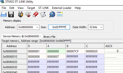

Data are stored in FLASH and I can check it in STM32 ST-LINK Utility:

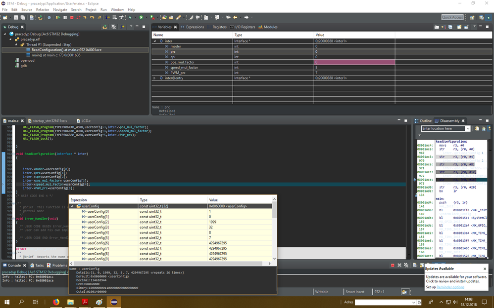

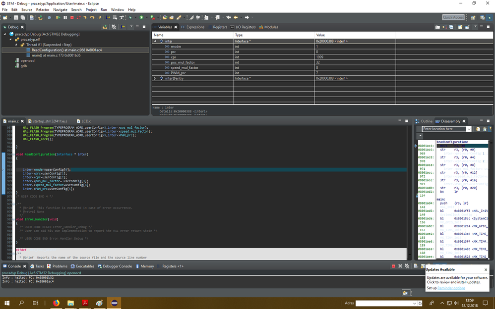

Hera are some screens from debug perspective:
This is after reading from keyboard and writing to FLASH:
Data in userConfig[] are correct but it writes 0 to "inter" variable

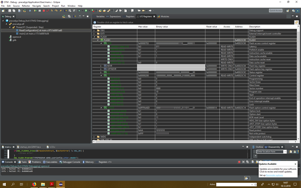

And here are FLASH registers:
The core is clocked by 100MHz so the latency is set correctly.
There is no read protection.

2018-12-18 6:05 AM
Compiler looks to be folding.
Check the address reported in .MAP file
Make this volatile not const

2018-12-18 7:50 AM
Thanks a lot! I've made this volatile and it works.
The mistake comes from here: https://stackoverflow.com/a/28505272
