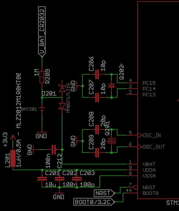

I designed a circuit that contains a CR2032 Battery for backing up the RTC.
The circuit is shown below. Without the battery the RTC is running well and an initialize of the RTC is no Problem.After inserting the battery the controller won't startup anymore.The program hangs while the RTC is initialize. The function is waiting that the RTC registers will be syncronized. But the RSF Bit will be never set.If i remove the battery the RSF Bit is immediately set. I also tried to connect VDD directly to the VBAT Pin, but that results in the same situation, the RTC is not working and the program is hanging.Is there something that i have forgotten to do?

IMO LSE stopped running while BKP_DR1 retained its content.
[EDIT] test this hypothesis by removing battery, shorting VBAT to GND (shorting the 100nF cap on it), replacing battery, trying to run the code

If you insert battery in unpowered state, it should NOT start to oscillate until the code enables LSE, i.e. until you power it up - regardless of if you touch it or not.
If LSE starts to oscillate without explicitly powering the mcu up, then you have some parasitic power to VDD, either from some external source (debugger?) or from the battery.
