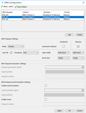

I use STM32H743ZI two SPIs with DMA to collect data. The data are OK when only one SPI with DMA is activated. However, when I use two SPIs with DMA to collect data simultaneously, the data collected are not correct.
The DMA setup:Codes to collect data using SPI with DMA:

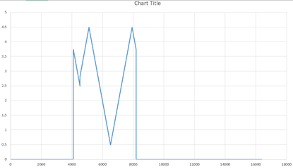

I use SPIs with DMA to collect a triangular signal (16 bit) at ~600KSPS, and save and transfer the data to data[]. If I only use SPI2 with DMA, the collection data[] is,
The collection is good.

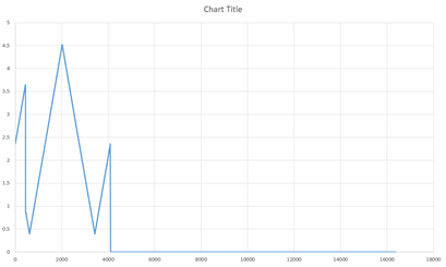

If I only use SPI3 with DMA, the collection data[] is,The collection is good.

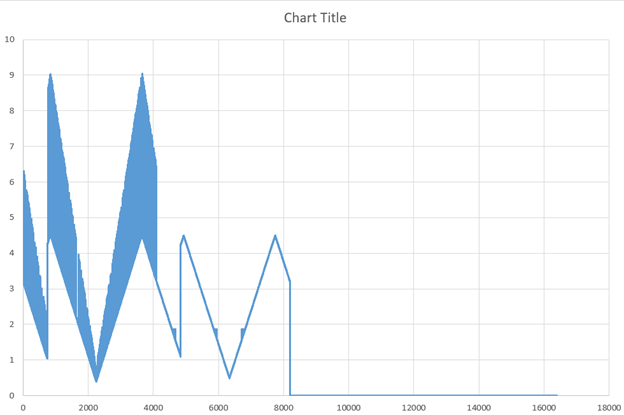

However, if I use both SPI2 with DMA and SPI3 with DMA to collect the signal simultaneously, the collection data[] is,
The collections from both SPI2 and SPI3 are distorted.
