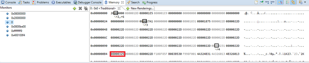

Interruption table:

2017-06-08 5:15 AM
The interrupt number from xpsr matches the USART4... it's a hummm...

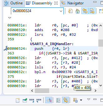

What exactly is on address 08000324, can you show us (disasm)? Do you have a breakpoint at that address, or only at 0x0800BE00?

I have my USART3_4_IRQHandler at 0x08000324, and I have a breakpoint on there. See picture below:
