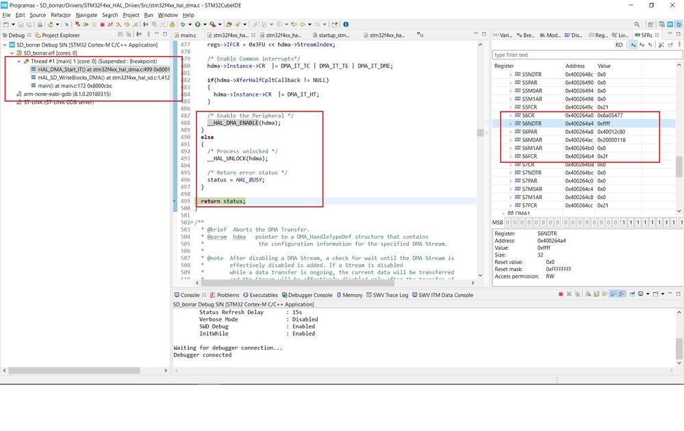

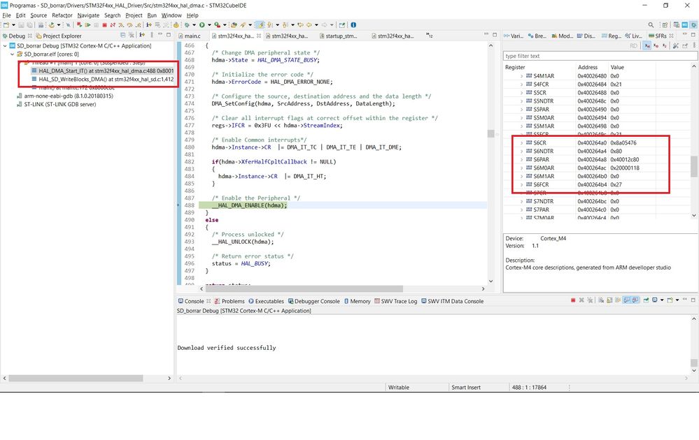

When it calls HAL_DMA_Start_IT, the DMA that was prepared to send 0x80 words, happens to have in the counter 0xFFFF, so it has sent all the prepared information to SDIO and (which is even more strange) one more word.
After activating the DMA, this happens:
Possibly this error is caused by some defects in the F411 hardware, the known ones are described in the Errata sheet.
The truth is that the DMA should have waited for SDIO to start requesting data from it, then the SDIO data request signal is active when it is disabled.
My workaround has been to program SDIO first and program and activate DMA later.
