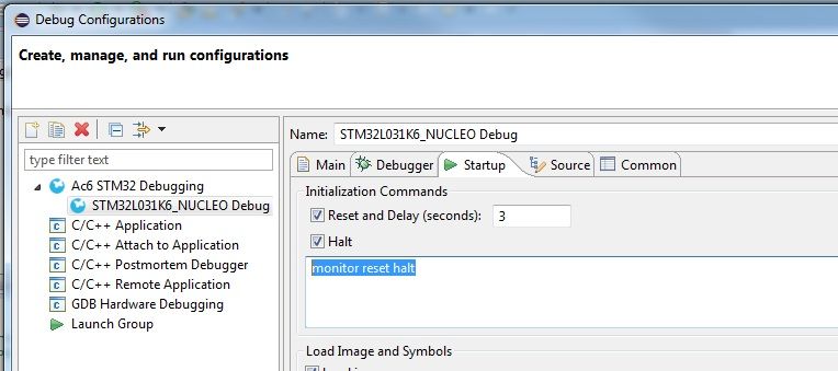

Hi oziom.dominik,
This error is due to pendings debug sessions. You launched a new debug session without terminating last one. To resolve this problem follow these steps: click Window->Open Perspective->Other->Debug, in the Debug view click verify that all debug session are off (equivalent to terminate). Otherwise open ocd is responsible of resetting the board. So, be sure that in Debug Configuration->Start up, Halt is chacked and ''monitor reset halt'' is written.2015-08-07 3:10 AM
