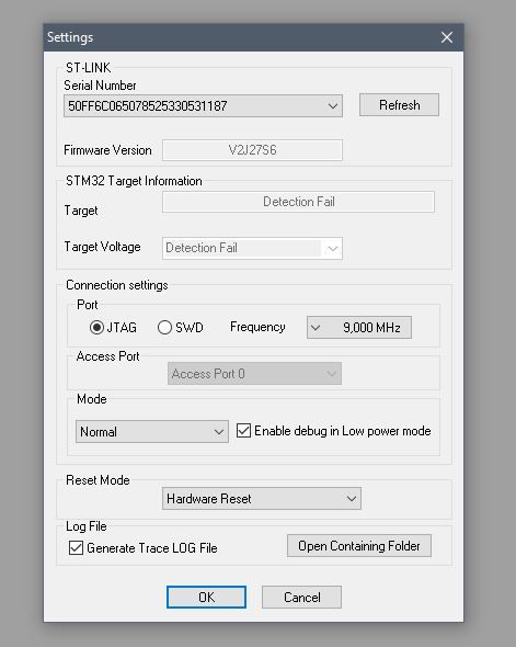

I use the STLINK with this settings :

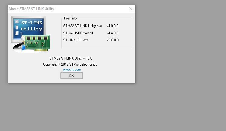

i use this STM32 ST-LINK utillity
2021-02-25 10:25 AM
The ST-LINK Utilities have also been deprecated in favour of STM32 Cube Programmer
I think this is a pity, but nevertheless it is the state of affairs.

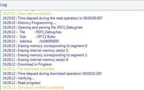

2021-02-25 10:33 AM
It's seems better..
