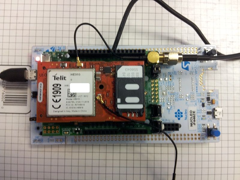

Don't they have an arduino shield adapter? That would make it easy to interface into a NUCLEO-144 (F429), or if you needed a screen, something like the F469-DISCO.
The modem likely needs a suitable power supply, probably beyond the 5V @ 500mA you can get from a USB connection. The IO voltages are compatible with the 3 or 3.3V used by most of the DISCO and NUCLEO boards.
If you want to wire it directly, you can RTFM, review schematics for the evaluation board or shield adapter.
I've hooked up my modems to NUCLEO's before,
