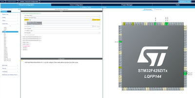

Hello @jchang98
When I followed the steps mentioned above :
Using PD11 and PD12 as address bits will cause a conflict with the FMC_NE3 (Flexible Memory Controller Chip Select 3) signal. This conflict will result in the FMC becoming partially disabled, limiting the maximum number of address bits you can use to 16 bits instead of the intended 18 bits
To avoid this issue, I recommend selecting different GPIO pins for the address bits, such as PC13 and PC14. This will ensure that the FMC functionality remains fully operational.
Additionally, the usbd_cdc.h file have been successfully included in my project, and the project was built with 0 errors and 0 warnings. Here is the IOC configuration for your reference.
2025-02-12 9:30 AM
Hi Ghofrane,
Here is my .ioc file. For PD11 and PD12, I had them assigned as FMC_A16 and FMC_A17, respectively. I thought these were address bits but I could be wrong.
I downloaded and imported the ioc file that you have given, but I still get the same problem when I include "usbd_cdc.h" in main.h. Maybe it's a problem with my setup?

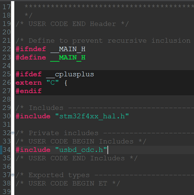

@jchang98 wrote:4. After saving and generating code, I included usbd_cdc.h to my main.h header. Building it generates 308 errors
Where, exactly, did you include it?
Maybe the order matters?
Perhaps get a preprocessor listing to see what the compiler's seeing?
@Ghofrane GSOURI wrote:Additionally, the usbd_cdc.h file have been successfully included in my project, and the project was built with 0 errors and 0 warnings.
@Ghofrane GSOURI perhaps you could also share where, exactly, did you include it?
2025-03-12 6:46 AM
I included it where there are comments saying where user private includes should be written. Is this wrong?
As far as I know, the other included file does not depend on usbd_cdc.h, and vice versa.
