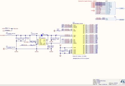

Is it also used by the LCD? because from the schematic I see that it connects to the ethernet port which I don't use.
the link to the schematic is https://www.st.com/resource/en/schematic_pack/mb1381-h750xb-b01-schematic.pdf

Hello @Maximiliano
As you can see on the https://www.st.com/resource/en/schematic_pack/mb1381-h745xi-b03-schematic.pdf the pins PD12 AMand PD13 are mapped to LCD_SCL and LCD_SDA:
So, those two pins are used by the LCD screen.
Best Regards.

Ho as I didn't see it, I thought it was on the ethernet only. I will have to look for another i2c to use although I suspected it because of the logic analyser. Thank you very much !
