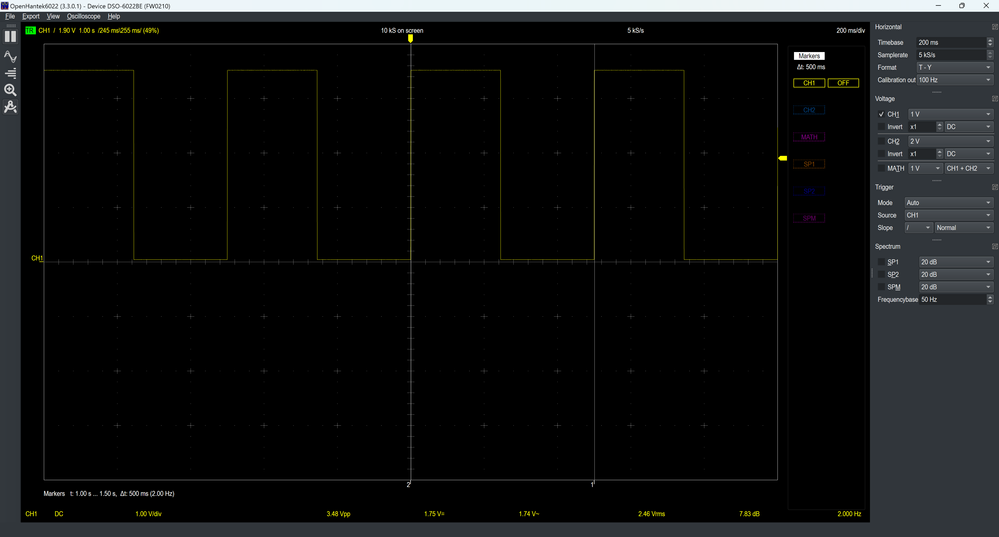

BTW, test signal:

As it would be very probable, it turned out it was a hardware bug I wouldn't expect. It turns out the software behaved correctly. There was indeed a rising slope, however, not visible on oscilloscope using the time base I used. It was a short spike introduced by a combination of a capacitor and the wiring. After removing the capacitance the device worked on the test signal from the PWM generator, however, it refused to work with the real sensor signal due to large, high-frequency spikes present in the singal. I solved the issue by replacing hardware edge detection with a software edge detection and a simple digital filter ignoring high frequency changes. It turns out the problem is low frequency counting with imperfect signal. The problem is really difficult to solve. It would take either additional input buffer and / or advanced digital filter. I'm testing adding some result averaging to provide a reasonable trade of between measuring accuracy and speed. I'm surprised how well H747 behaves sampling the signal at 50kHz.
