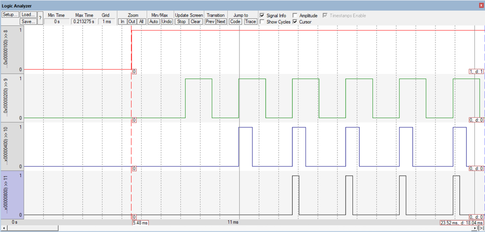

Here is the picture I get in Keil's Logic Analyser
I'm using simulator now and in a long time will not be able to test program on a real MCU.

Thank you all for your help. I finally got access to my board and to a real logic analyzer (thanks quarantine for all that wasted time hehe), The Tim DMA-burst feature works fine irl, problem was in the Keil's simulator.
OK, but this can be also consequence of the simulator not being perfect.

2020-05-04 3:49 AM
2020-05-04 1:01 PM
Thanks for coming back with the solution.
The 32-bitters are extraordinarily complex breasts, even the simplest of them is. It's next to impossible to build a faithful simulator.
