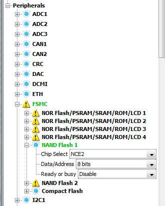

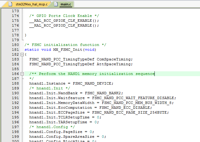

2018-01-30 12:13 AM
Hi
Matras.Tugrul
,Granados.Elkin
andTekampe.Jens
,Regarding
Matras.Tugrul
'spost, you can change the value ofhnand1.Init.Waitfeature in the pinout view/FSMC/Nand Flash1/ Ready or busy (I am working on the lastest CubeMX release 4.24) :
it will automatically generate the following code :
BR. Jeanne
