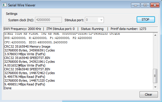

Hi Clivel
Update of the board. I got a board STM32F4DIS-BB fromhttp://www.newark.com/stmicroelectronics/stm32f4dis-bb/expansion-stm32f4-cortex-m4-for/dp/47W1731
Tested the connection. Clearly the error is caused by the connection problem,maybe signal interference . I will move forward to test my own code. Thanks Clivel.2015-06-15 8:35 PM
