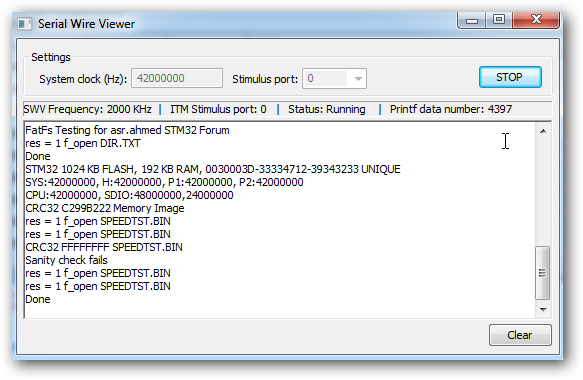

Clivel
I am using DMA.The screenshot is as shown.By the way I am using 16gb microsd.There are pull up resistor connected for D0-D4,and Cmd. No resistor for clk.Please give further advise.thanks2015-05-31 9:55 PM
This would suggest to me that the interface is not functional, you need to double check what you've built, or use a STM32F4-DIS-BB board to confirm things are working with that.

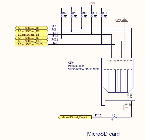

The SD Slot/Socket is expected to be wired as follows
CARDDETECT = PC2 (Retargetable)
CLK = PC12
CMD = PD2
D0 = PC8
D1 = PC9
D2 = PC10
D3 = PC11
VDD = 3V
VSS = GND
PC10 (SCLK) and PC12 (SDIN) potentially conflict with the CS43L22
The CMD, D0, D1, D2, D3 pins should have 33K or 47K pull up resistors.
