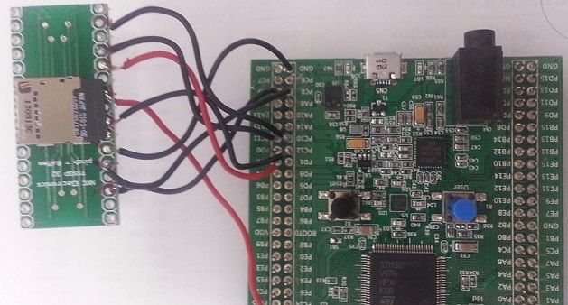

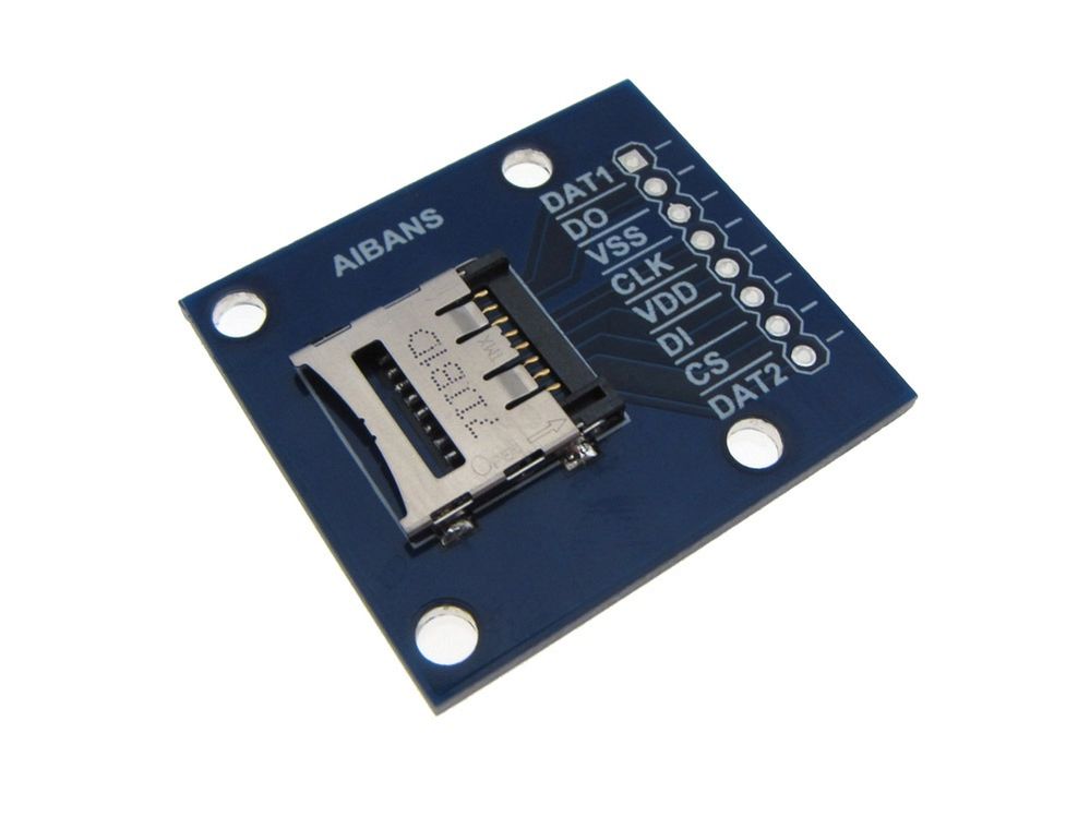

This is is very simple project, using stm32f4 discovery and wired microsd socket to read/write data to microsd card.
the code is generated by the stm32f4cubemx.However error occurs at f_open, tracking down it shows FS_DISK_ERR in ff.cPlease help..The code for reading/write is: /* Register the file system object to the FatFs module */ if(f_mount(&SDDISKFatFs, (TCHAR const*)SD_Path, 0) != FR_OK) { /* FatFs Initialization Error */ Error_Handler(); } else { LED_ON(ORANGE,1); /* Create and Open a new text file object with write access */ if(f_open(&MySdFile, ''STM32.TXT'', FA_CREATE_ALWAYS | FA_WRITE) != FR_OK) { LED_ON(RED,1); HAL_Delay(2000); LED_ON(RED,0);HAL_Delay(1000); /* 'STM32.TXT' file Open for write Error */ Error_Handler(); } else { LED_ON(BLUE,1); /* Write data to the text file */ res = f_write(&MySdFile, wtext, sizeof(wtext), (void *)&byteswritten); if((byteswritten == 0) || (res != FR_OK)) { /* 'STM32.TXT' file Write or EOF Error */ Error_Handler(); } else { LED_ON(GREEN,1); /* Close the open text file */ f_close(&MySdFile); /* Open the text file object with read access */ if(f_open(&MySdFile, ''STM32.TXT'', FA_READ) != FR_OK) { /* 'STM32.TXT' file Open for read Error */ Error_Handler(); } else { /* Read data from the text file */ res = f_read(&MySdFile, rtext, sizeof(rtext), (void *)&bytesread); if((bytesread == 0) || (res != FR_OK)) { /* 'STM32.TXT' file Read or EOF Error */ Error_Handler(); } else { /* Close the open text file */ f_close(&MySdFile); /* Compare read data with the expected data */ if((bytesread != byteswritten)) { /* Read data is different from the expected data */ Error_Handler(); } else { /* Success of the demo: no error occurrence */// BSP_LED_On(LED4); } } } } } }2015-06-01 8:46 PM
The board I am using is purchased from
http://www.ebay.com/itm/381265789938?_trksid=p2057872.m2749.l2649&ssPageName=STRK%3AMEBIDX%3AIT2015-06-01 9:19 PM

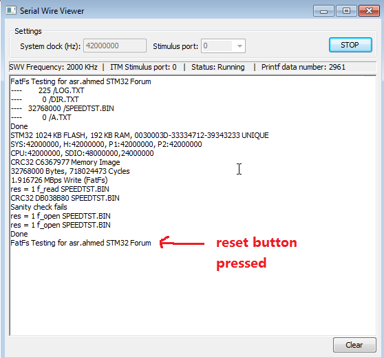

Just now, I retested it. The result is different.
It may be because of the connection problem of uSD card?When I plugged in, it shows it can write. But after I push the reset button, it freezes.Tomorrow I will try to use another socket board and test again.Thanks2015-06-02 9:15 AM

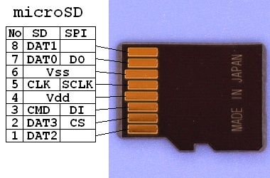

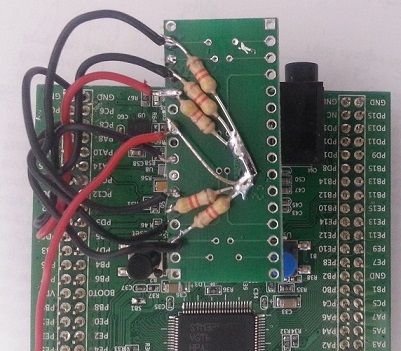

30K should be fine, I picked 33K as it's what I had to hand. My wire lengths were in the order of 1-1.5'' (25-40mm)
8 PC9 DAT1
7 PC8 DAT0/DO
6 GND VSS
5 PC12 CLK/SCLK
4 3V VDD
3 PD2 CMD/DI
2 PC11 DAT3/CS
1 PC10 DAT2

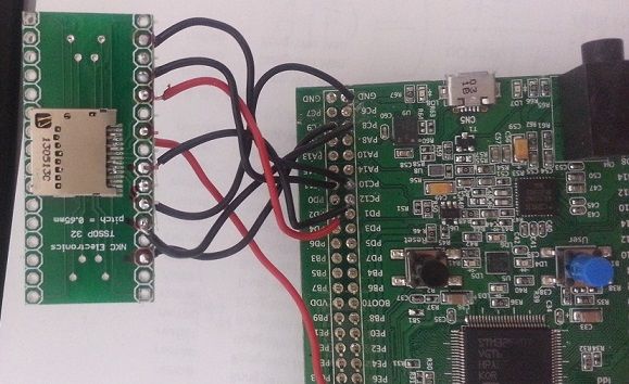

2015-06-02 1:10 PM
Still getting the error after I resolder to another board using molex socket. I believe the connection is solid and perfect.
I usedmultimeter to checked the connection.2015-06-02 1:20 PM

I suspect the wiring (length and layout) does not support ''higher megabit'' data rates.
Try scaling down the SDIO clock by one order of magnitude2015-06-03 10:44 AM
Argentum,
I used pretty low clock frequency.Not sure what is going on.I am gonna to buySTM32F4DIS-BB to test.

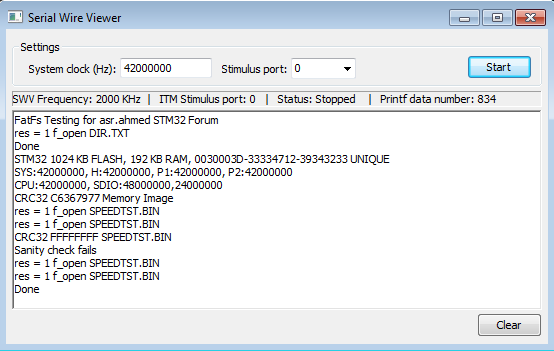

can you guide me how to implementSWV (Serial Wire Viewer) using SWO (Serial Wire Output) output without loosing the function of fprintf? I want to output debug info to SWV but I still want to access microsd reading/writing.
// STM3221G-EVAL SWV Test - SOURCER32@GMAIL.COM
#include <
stdio.h
#include <
stdlib.h
#include <
string.h
#include ''stm322xg_eval.h''
static int Debug_ITMDebug = 0;
void Debug_ITMDebugEnable(void)
volatile unsigned int *ITM_TER = (volatile unsigned int *)0xE0000E00;
volatile unsigned int *SCB_DHCSR = (volatile unsigned int *)0xE000EDF0;
volatile unsigned int *DBGMCU_CR = (volatile unsigned int *)0xE0042004;
*DBGMCU_CR |= 0x27; // DBGMCU_CR
if ((*SCB_DHCSR & 1) && (*ITM_TER & 1)) // Enabled?
Debug_ITMDebug = 1;
void Debug_ITMDebugOutputChar(char ch)
static volatile unsigned int *ITM_STIM0 = (volatile unsigned int *)0xE0000000; // ITM Port 0
static volatile unsigned int *SCB_DEMCR = (volatile unsigned int *)0xE000EDFC;
if (Debug_ITMDebug && (*SCB_DEMCR & 0x01000000))
while(*ITM_STIM0 == 0);
*((volatile char *)ITM_STIM0) = ch;
void Debug_ITMDebugOutputString(char *Buffer)
if (Debug_ITMDebug)
while(*Buffer)
Debug_ITMDebugOutputChar(*Buffer++);
int main(void)
/*!< At this stage the microcontroller clock setting is already configured,
this is done through SystemInit() function which is called from startup
file (startup_stm32f2xx.s) before to branch to application main.
To reconfigure the default setting of SystemInit() function, refer to
system_stm32f2xx.c file
Debug_ITMDebugEnable();
Debug_ITMDebugOutputString(''SWV Enabled
printf(''%ld
'', SystemCoreClock);
printf(''Hello World!
while(1); /* Infinite loop */
* @brief Retargets the C library printf function to the USART (GNU)
* @param None
* @retval None
int __io_putchar(int ch)
/* Place your implementation of fputc here */
/* e.g. write a character to the USART */
Debug_ITMDebugOutputChar(ch); // SWV
return(ch);
* @brief Retargets the C library scanf function to the USART (GNU)
* @param None
* @retval None
int __io_getchar(void)
/* Place your implementation of fgetc here */
/* e.g. read a character from the USART */
return((int)-1);
#ifdef USE_FULL_ASSERT
* @param file: pointer to the source file name
* @param line: assert_param error line source number
* @retval None
void assert_failed(uint8_t* file, uint32_t line)
ex: printf(''Wrong parameters value: file %s on line %d
'', file, line) */
#endif
2015-06-03 10:34 PM
