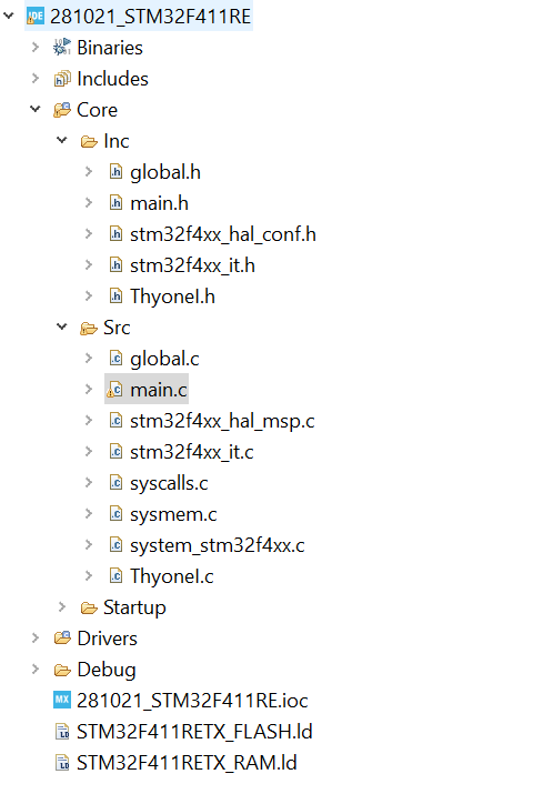

Can you show me the structure of your project ?
BR.
AMVE.1
2021-10-28 8:19 AM

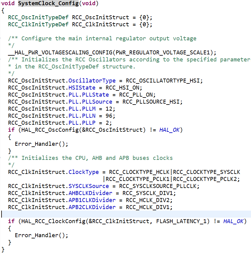

2021-10-29 2:47 AM
Hello CAben.1,
You need to make some updates on your code :
/**USART1 GPIO Configuration
PA12 ------> USART1_RTS
PA11 ------> USART1_CTS
PA10 ------> USART1_TX
PA9 ------> USART1_RX
BR,
2021-10-29 7:07 AM
Hello AMVE .1,
Thank you for your response. I made the suggested updates and got the project running sucessfully. Thank you.
