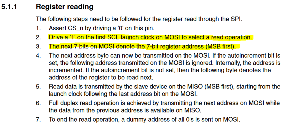

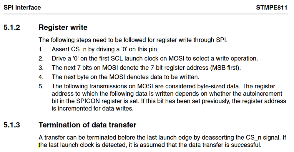

Hello Ali
Fist observation
You break the Touch_SPI_WriteReg8 and Touch_SPI_ReadReg8 transactions, in two pieces by pulling CS HI state and low after, in the midle of transaction. Is not correct.
Second observation
Touch_SPI_ReadReg16 Must not been broken in two 8bit transactions. Must be continous . means that you push CS to LOW before transaction and pull it to HI after transaction.
Regards

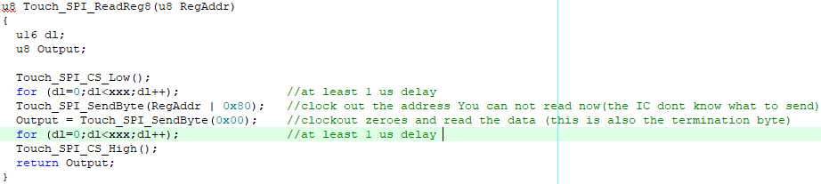

2017-08-31 2:40 AM
Hi
>>>My problem is that I have to send each message twice and I know there is a problem. Did you see such thing in your project?
Defintely not.
Let 's go gain to Touch_SPI_ReadReg8 function.
The function first gives the address and closes the transaction by write 0. Why to do this without read the data?
At second part reads ''Output2 = Touch_SPI_SendByte(RegAddr | 0x80);'' . This data is useless. You can't read data the same time you give the address .
My suggestion is a read function for 8 bit registers like this (look at the coments)
Finally, I fully agree with
Littell.David
