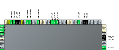

The issue for is that all the pins for CAN1 are used by LTDC and FMC
From what I see the possible pins for CAN1 are PB8 PD0 and PA11 for CAN1_RD and PB9 PD1 and PA12 for CAN1_TD. PB8 PB9, PA11 PA12 are used by LTDC, and PD0 and PD1 are used by FMC ( SDRAM1 Data).

CAN1 is not available with TouchGFX. As you said, all the available CAN1 pins are either used by LTDC or FMC:
Meanwhile CAN2 is available. You can use it on PB12/PB13.
