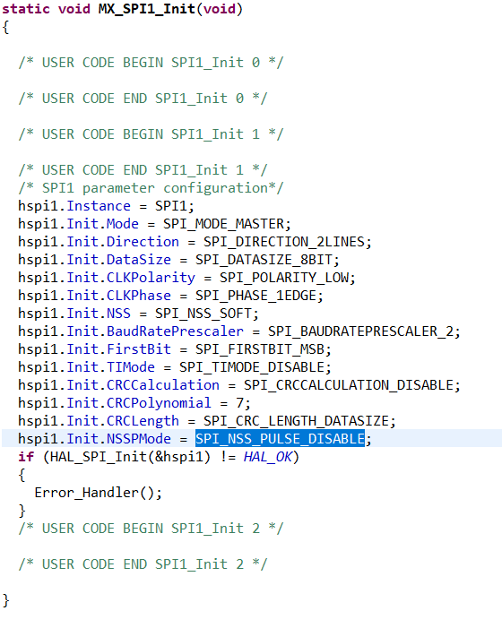

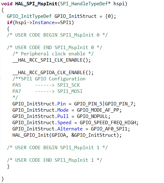

Here are the generated Init functions:

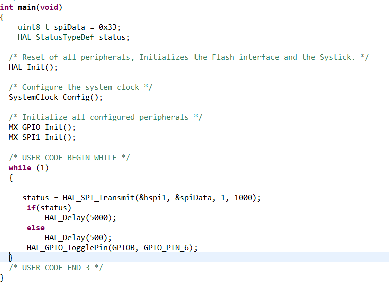

Here is my main. I am simply sending one byte over and over looking for signals on the line.

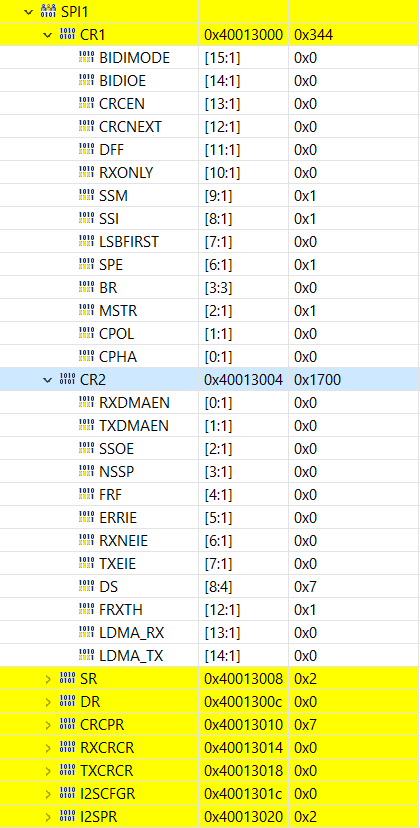

Here is the state of my SPI1 registers right before I transmit over SPI.
It seems like the NSS and NSST have caused a lot of problems for people but I have NSS pulse disabled. I admit that I dont have the greatest understanding of what NSS and NSST are doing.

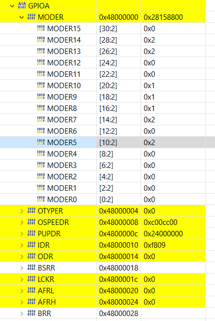

My GPIO registers are below. The PA5 and PA7 pins (CLK and MOSI) look like they are correctly set up for alternate functions.

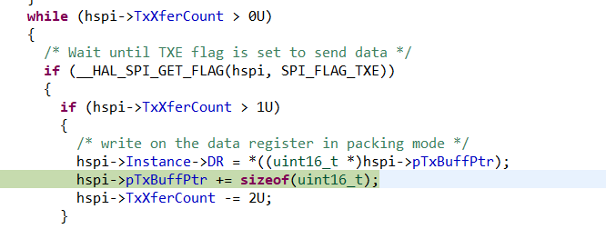

Interestingly enough when I call the SPI_Write function and eventually get to where it puts the data into DR:

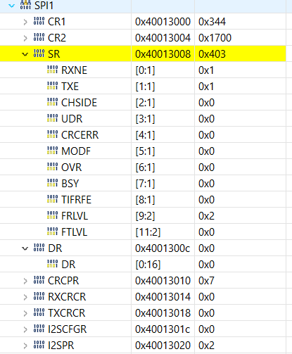

I dont see the DR register change from 0 at all. But the SR does change when I step over that line:
My TXE bit stays 0x01 the entire time which seems odd. And RXE changes from 0 to 1 after I step over that line. That seems backwards? My FIFO reception level bits change as well. Once again this seems backwards?
Is a combination of my CR bits making me actually receive bits instead of transmit? This seems very weird to me.
When you send a byte over SPI, you also receive a byte. This is not unexpected. That's just how SPI works in two-direction mode.
The DR register is not a memory cell. It's a register to send data out and receive data from. If you write something to DR, you should not expect to be able to read it back. In your setup, you write MOSI and read MISO.
By reading SPI->DR in your debugger, you are resetting the RXNE bit. Probably not what you want.
I think it all could be explained by a hardware error. If you set the pins as GPIO, can you toggle them?
