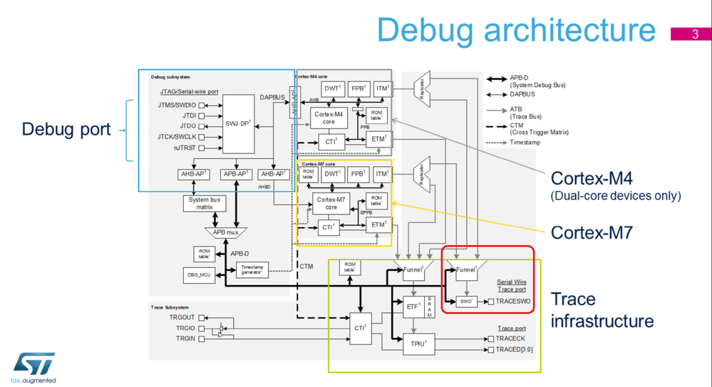

I'm connecting with the M4 access port 3. I think each core has it's own ITM as shown below. There's a MUX for the SWO that's controlled with SWFT_CTRL:ENS0/1, but when I manually changed that it still didn't work.

2021-07-13 3:37 AM
I managed to get trace working from the M4. I had to set the SWV - Core Clock: setting to the M7 clock speed and not the M4 clock speed.
If you enable trace logging from one core the IDE wont allow you to enable the 2nd core. If you get in this situation you need to power cycle the board.
But after some more playing it appears the correct M7 Core clock value is taken from PLL1R (DIVR1) output, but I can't see anything that talks about this. Also if PLL1R isn't enabled (as in my first example) then it's the M7 SysClk value.
I feel I'm just having good guesses at the SWV Core Clock value. What I really need is the correct way to find the SWV Core clock value.
