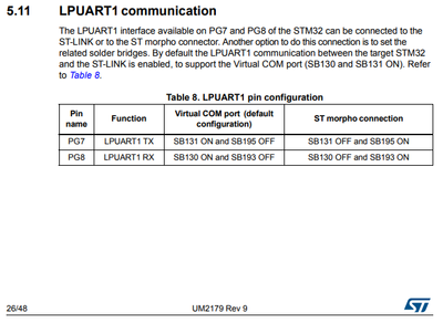

2024-02-28 2:50 AM - edited 2024-02-28 2:52 AM
@Andrew Neil wrote:These things are also documented in the User Manual, UM2179:
Although UM2179 omits this from Fig 3
:face_with_rolling_eyes:
See separate post:

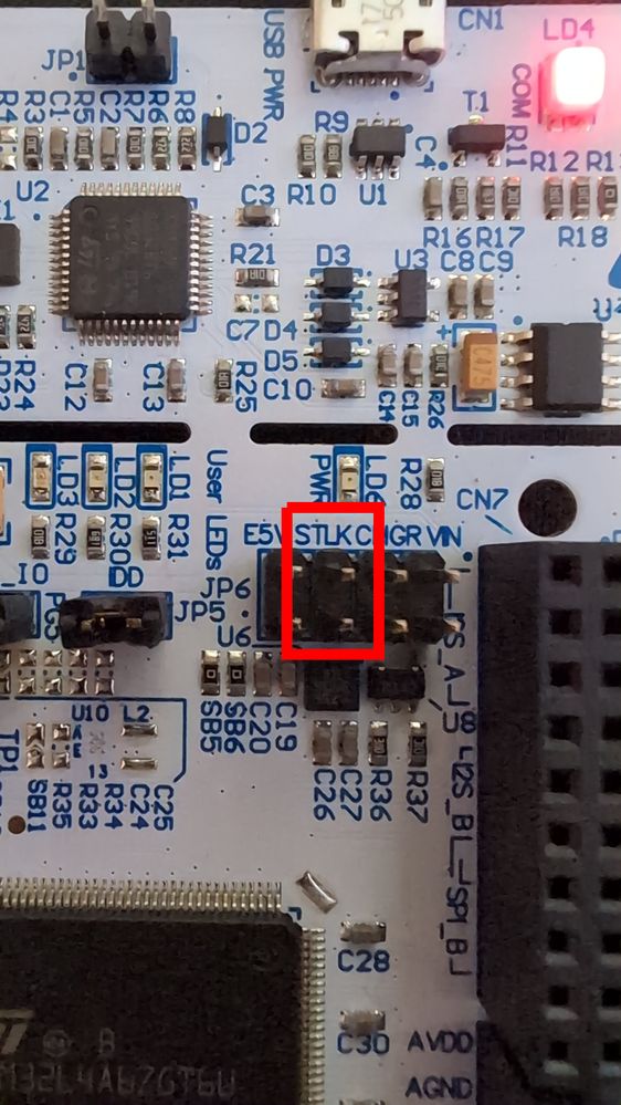

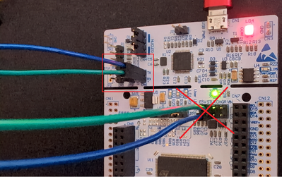

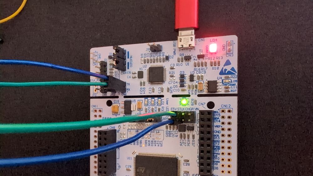

2024-02-28 3:02 AM
Sorry if i need to ask again. But does the the STLK_RX/TX refer to those two pins?
I tried to connect RX/TX to them like this. But it didn't work either:
I'm sorry for those dumb questions. Currently feeling totally overwhelmed by all the schematics and documentation. If there is a more straight forward way to configure printf i would of course do use it too.
2024-02-28 3:06 AM - edited 2024-02-28 3:10 AM
Remove the ones crossed.
You have to use the one in rectangle and you have to connect UART2_Tx/UART2_Rx from CNx connectors

2024-02-28 3:14 AM
Okay now It works. Thank you so much for your time and patience!

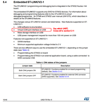

@mƎALLEm This is a common issue that comes up quite a lot.
As well as clarifying the VCP UART connection diagram (as already mentioned), I think the ST-Link section should specifically state what UART the VCP connects to, and cross-reference to the section with the details:
Perhaps also something could be added on "how to use a different UART" ... ?
2024-02-28 3:43 AM - edited 2024-02-28 3:43 AM
I think it's something managed in transversal. Each board has it's own UART (sometimes USART1, others USART3, others LPUART1 etc ..). So I think it's not easy to manage in the documentation.
2024-02-28 3:59 AM
Fair, although the UM2179 here does specifically refer to LPUART1:
There should at least be a cross-reference from the ST-Link section to this section (or its equivalent).
2024-02-28 4:55 AM
Yes this is a specific section for this board while the other (I think) is a generic paragraph that implies all Nucleo boards.
Does this kind of specific paragraph available in all UM?:
