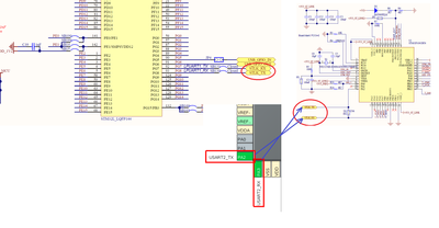

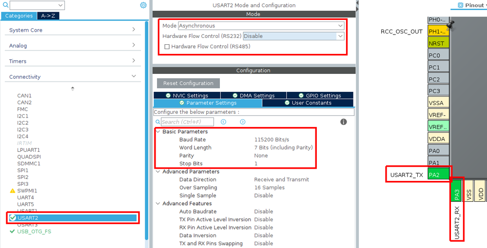

Here what I've tried so far. I connected the `USART2` to the Pins `PA2` (RX) and `PA3` (TX):
(By default LPUART1 was configured and connected to PG7/8, since the forum post used USART2 I used it as well.)
After the configuration was saved, and the code generated, I used the code from the previous mentioned forum post. Here a shorter and with comments removed version:

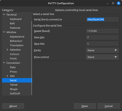

I wanted to connect via PuTTY. I turned Flow Control off, and set the data bits to 7. Here are the settings:
When I select open I can connect, but the terminal stays just empty.

You need to look at the NUCLEO-L4A6ZG schematics from this link.
You need to connect USART2_Tx to STLK_RX and USART2_Rx to STLK_TX.
By default LPUART1_TX is connected to STLK_RX and LPUART1_RX to STLK_TX.
So your UART2 is not exposed to the virtual comport in STLink.
PS: make sure LPUART1_TX pin (PG7) is not configured. Keep it in analog input configuration.

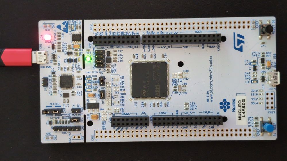

I haven't change anything on the board so far:

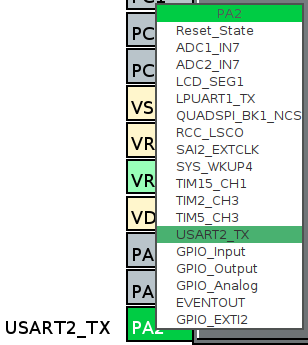

To the point "what is the config of USART2_TX gpio pin?" I just selected the PA2 Pin and assigned USART2_TX.

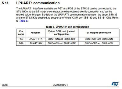

@stmax wrote:How can I check wheter it's connected. Is it something on the physical board or in the software?
As @mƎALLEm suggested, the schematics are the key to see what's connected to what.
These things are also documented in the User Manual, UM2179:
This tells you that the default (out-of-the-box) configuration of the board is to have LPUART1 connected to the ST-Link's VCP.
Therefore, if you want to connect a UART other than LPUART1 to the VCP, you will first have to disconnect LPUART1, and then make the connections to your desired UART.
2024-02-28 2:46 AM
He can keep SB130 and SB131 soldered (as he's a beginner and can damage the PCB) but he must ensure that PG7 and PG8 IOs keep default GPIO pin settings (GPIO input).
