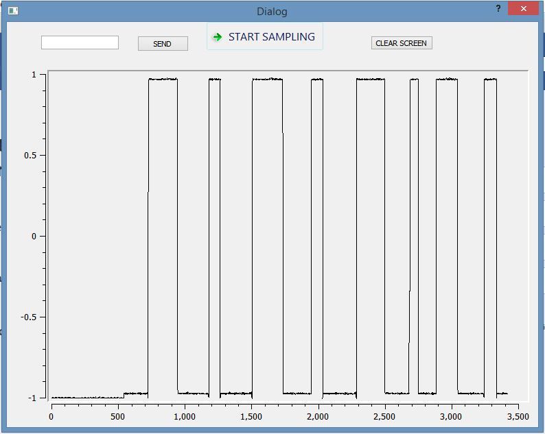

I want to have precise ADC readings on stm32f4 for my project work but it always give me about 1% of error. For example if i take 0 V reading by grounding 12bit ADC it gives readings in between 0-15 (out of 4095 steps).Also attached is the wave generated from DAC and i take its reading from ADC and ploted in QT through Virtual Com Port. as you can see there are some fluctuation in values even when voltage is constant.2015-09-08 11:53 AM
Yes, the STM32F4 ADC is disappointingly noisy. You might want to review AN4073, but don't expect miracles. Analog circuitry madufactured on digital-optimized process has its limitations, especially if integrated with a relatively large digital circuit onto a single piece of silicon. You might want to consider an external ADC if you desire better accuracy and/or lower noise.

Thanks for your reply. Its really disappointing to hear this. May be i will try some software filter because i can not afford to ship external ADC chip as it takes more than a month to reach a product in my country and i have got to submit my project. Or do you have any other better solution ?

I have nothing better. You can also try to decouple the analog supply from digital using RLC filters, and you can try to reduce digital noise by reducing/stopping core and avoiding switching external loads during the conversion. None of this will have dramatic effect, probably, but maybe together might yield the desired result.
