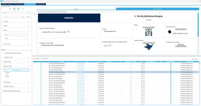

Easiest way is to just create a new Project, then select the example you want from the example selector:
Then the IDE will do it all for you ...
