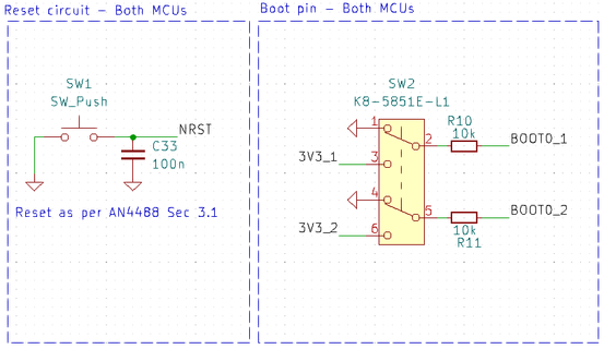

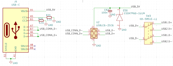

I am working on a board containing two STM32F412, and I am having a hard time reaching the DFU bootloader:
The schematic is illustrated below:
The reset and boot pin schematic is illustrated below:
The schematic is fully consistent with the design we usually use without issues, except for the details relating to having two MCUs instead of only one.
Any suggestions as to what might cause the issue we are seeing would be greatly appreciated.

I figured it out.
I had forgotten that BOOT1 is a physical pin on the F412 (PB2) - I had left it floating in my design, so the wrong boot mode is selected.
If I manually ground PB2 with a jumperwire during reset, the correct bootmode is selected, and the DFU kan be reached as intended.

Thank you for your reply, although I am not certain I understand - Can you elaborate what you suggest I should try?
To elaborate on my issue:
You mention that the USB PHY might not fulle reset with the NRST reset - Is there a better way to conduct a reset, or something else I could try?
Best regards

I think I maybe understood your suggestion:
So as you suggested, it seems that the issue lies not with the USB connection via the cable, but the internal reset of the USB phy.
What can be done to fix this - I have measured the NRST pin with an oscilloscope when the reset button is pressed, and it does go to 0V, which it what we usually do, so I am not sure what may be preventing the reset in this board?
