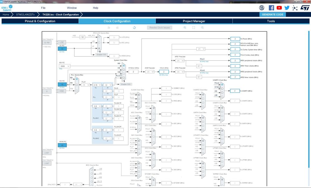

I am using stm32l496 in lprun mode but the current consumption is equal to 1.2 mA while in run mode the current consumption is equal to 3 mA while in the datasheet, the current consumption in the lprun mode is about 220 uA.
how can I reduce the current?
i attached cube clock configuration and my code.
Thanks.

2021-09-25 1:55 AM
Set DBGMCU_CR = 0; and disconnect the debugger physically.
