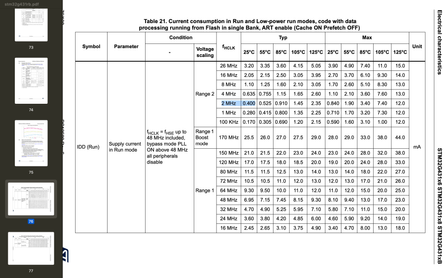

I checked the current consumption of the chip on the datasheet and I got this:
i want to use the board in a range of 2 MHz so i use :
0,4 mA for it

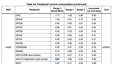

then, the board will only use the 11 ADC and the FDCAN as a normal CAN (at 1MHz):
0,0080*2 = 0,0016mA
0,006*2 = 0,0012mA
I did not find any information on the main functions that I will use (the HAL libary to control the DMA and the CAN) so I do not know how much to add more, but whith those little values of current, I think then that it is enough for me to note that I do not need any other power supply to power up my sensors, am I right? Thank you
