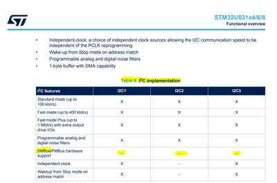

As mentioned in the datasheet, the I2C on STM32U031 does not support the SMBus feature.
Thank you.
Kaouthar
