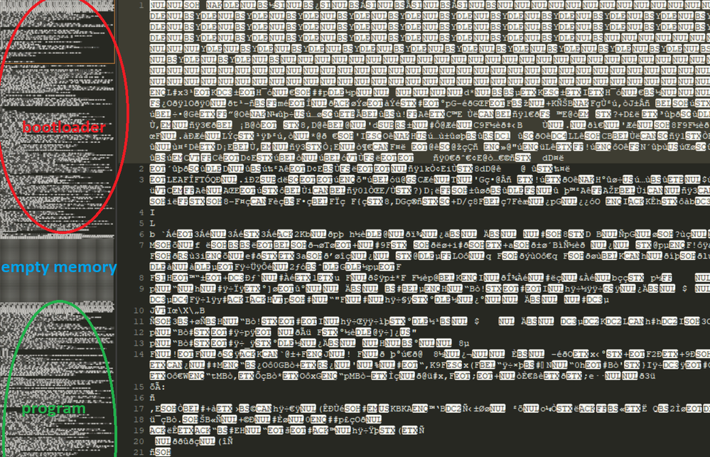

If what you want to do is read what is written inside the microcontroller so you can change some code.
Short answer no.
Long answer:
What the microcontroller memory contains is the already compiled machine code (unless youre using micropython or some other satanic scripting engine).
This means youre just going to be able to read BIP BUP BIP, maybe some static strings. Reverse engineering that would be VEEERY HARD.
