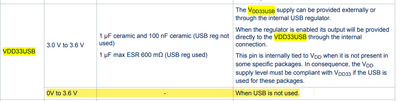

also will you check on below snap?
if not used 0v to 3.6V. I not sure if 0V to 3.6V means not we can keep it NC.

2025-05-19 12:34 AM - edited 2025-05-19 12:37 AM
From ds , 0...3v6 allowed, NC should be no problem for function of cpu.
But as always: a floating input (here power input) is not the "perfect" design idea.
