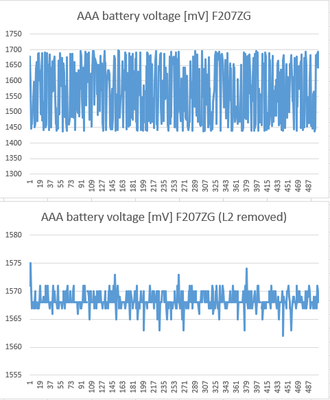

SOLUTION
Luckily I've found this post:
https://community.st.com/t5/stm32-mcus-products/fluctuations-in-adc-value-of-stm32h743-mcu/td-p/331487/page/2
The author of the solution said that Ethernet PHY causes the ADC noise problem and recommended to remove L2 coil which turn off this interface. I did so and below there are results before and after:
Standard deviation of measurement dropped hugely from near 90 to 1,5.
It seems to be problem with every H7 Nucleo board as each has PHY. The conclusion is that there is no way to use both Ethernet and ADCs, since ADC averaging/oversampling isn't possible in every situation.

2024-04-14 9:00 PM
Sounds like you have cut down the noise greatly. In general, if I had to do precise ADC measurements with a nucleo board, I would create a separate daughter board with its own very low noise linear voltage regulator and amplifier to buffer the signal before it got to the nucleo board. To take it one step further, I would have a separate ADC chip on that daughter board and just communicate with it via SPI. I would use plenty of surface mount ferrite beads to block high frequency noise (and plenty of capacitors too)
