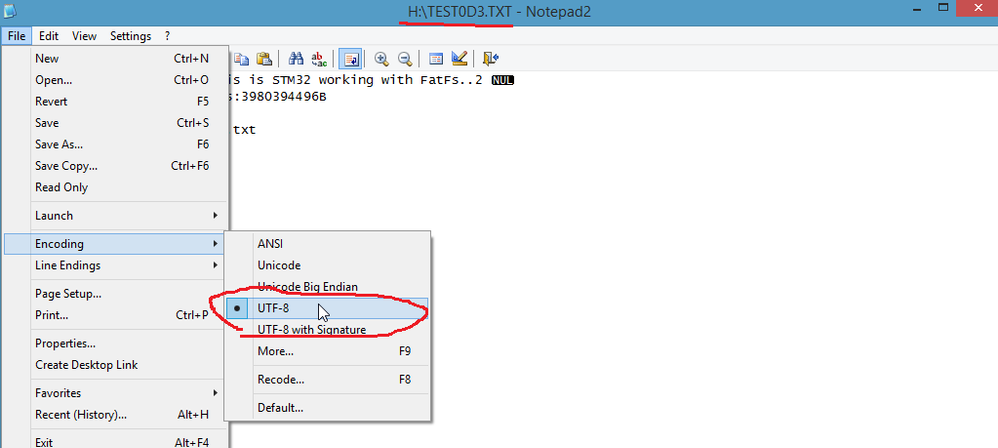

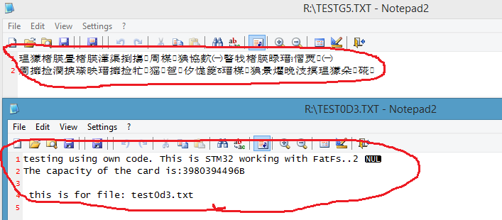

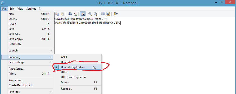

I developed a board using STM32F411 chip with uSD card.The code is generated by cubemx. only add a little bit code in main(). The hardware is OK. I can correctly write a file to sd card. But the weird thing is that the filename accepts 7 chars, not 6 chars. If I use 6 chars in the filename, the character encoding is totally different.
In the testing I only change the filename. I attached two files generated by the chip.why the program uses two different encodings
for the files
just because I use different filenames
? The file with 7 chars in filename always uses utf-8 encoding.2. how to correctly set the encoding
.Actually in the file I specify it to use ANSI encoding, as in ffconf.h. Why the program uses others?
Please help.The two txt files and the ffconf.h are enclosed as attachment.
