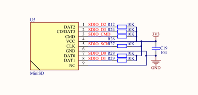

What is the "slot's CD pin " ? micro SD , see ->
...and this is connection on F407VET black board :

2025-06-18 1:42 AM - edited 2025-06-18 1:44 AM
Ok, now i see: you puzzle the 2 possible interfaces : SPI (with CD/CS ) vs. SDIO (no CD, but 4 data lines) .
See in pic of card i posted: green(SPI) or blue names for interface on card.
So on using SDIO/SDMMC interface , as its here, there IS NO CD line !
