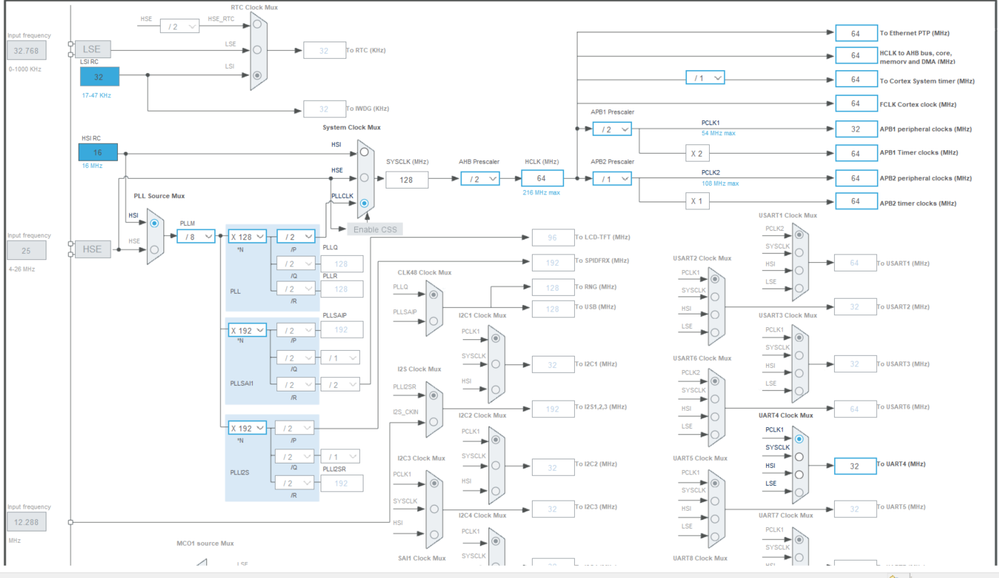

2024-03-18 4:38 AM
Can you please check my clock setup and tell me the ADC Sampling Frequency?
Here is the clock setup:
As I wrote before, I am setting sConfig.SamplingTime = ADC_SAMPLETIME_112CYCLES.
Thank you very much!
Vaclav
2024-03-18 5:16 AM
So AHB is at 64M now; divider 4 -> 16M ; = 62,5ns
adc sampl. 112 + 12 (12 bit resolution) -> 124 cyc.
16M / 124 = 129 kHz , sampling.
I always check real rate, its so easy to calculate wrong. :)
Simple check: make a loop with adc conversions and set /reset a port pin, maybe a LED is on a pin you can use.
Then look with scope, is it about the right timing.(if using HAL calls, they might need extra 1..2us , so just do a loop with 1000 conversions , should need about 8 ms . )
Or make longer loop, 10000 conversions, and check with reading HAL_GetTick(); and see time in ms steps; about 80 ms then.
