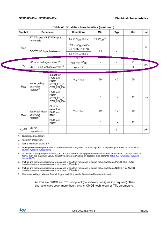

2018-01-22 6:46 AM
all I/O pins are high impedance
How high is high ? Can you put a number to quantify the impedance ?

So
Waclawek.Jan
scores a straight 2 on the RTFM-O-Meter !2018-01-22 8:12 AM
Thanks !
I was looking for 'impedance', 'Ohm', 'Ω' and similar keywords, not 'current'.
So, we're talking about MΩ impedance, which isn't particularly high. I have voltage dividers in the same order, having one connected to such IOs will be impact the circuit.
2018-01-22 8:32 AM
IMO this is result of having the latchup protection circuitry.
Mind, this is generally a digital, not analog, IC.
