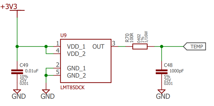

I've updated the question with the code. Some of the pins I've just been manually shorting to VCC (3.3) or GND, but PA0 is connected to a temperature sensor like below which is putting PA0 at 1.3V roughly. If multiple ADC channels are configured how do I know which one I'm converting when I receive the interrupt?
