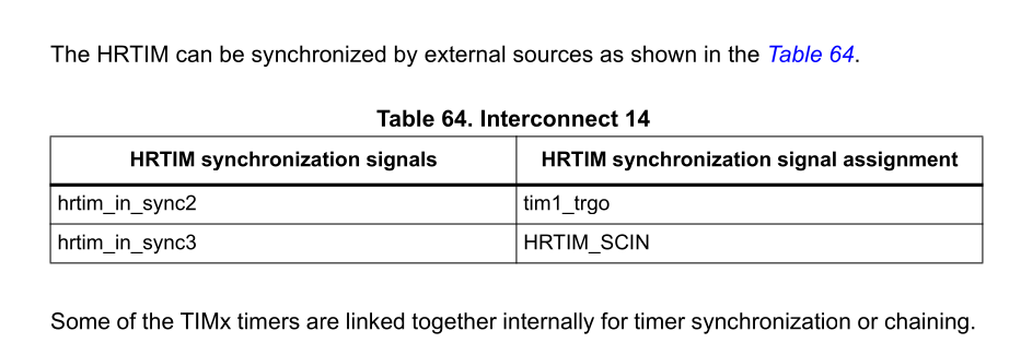

I wanted to generate without Phase shifted PWMs between HRTIM and Tim1 .
How can I do it? thanks for your support!

2025-07-03 7:00 AM
Start PWM on TIM1. Then, after a small delay, start PWM on HRTIM based on how much delay you want.

2025-07-04 4:18 AM
Look for Reference Manual RM0440
