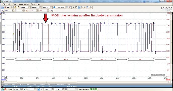

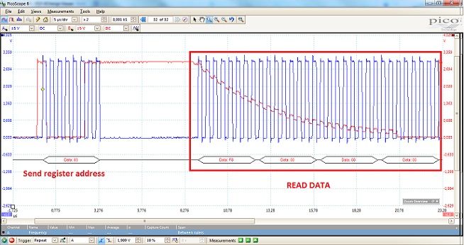

I'm tryng to use SPI in half-duplex mode on STM32F303VC microcontroller. The STM32 act as Master. MOSI line is used as data line for input and output. In my setup I have to send an address register using MOSI line and then read data trough the same line (peripheral is in half duplex) the problem is that after sending one byte, the MOSI line remains at high logical level.. This is not an issue when I need to send multiple data, as shown in figure transmission is fine. The problem is that when I switch to read modeSPI_BiDirectionalLineConfig(SPI2, SPI_Direction_Rx); the MOSI line is still up and corrupt the data (second figure)

Hi, I finnally come out with a workaround:
after sending the 8 bit address to avoid that data line remains high is necessary to reset the SPI peripheral.FilippoWe’re moving the ST Community to a new platform to give you a better and more reliable community experience.
