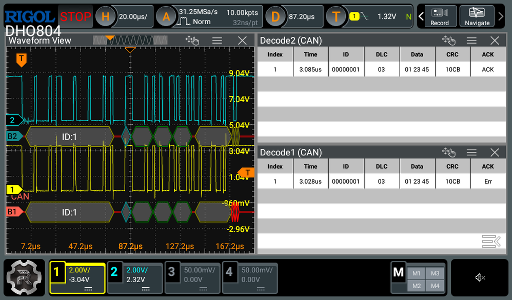

I have PD0/PD1 connected to a MCP2542FD transceiver. The CAN side of the bus is wired directly to a PEAK-USB FD Pro (wires about 10cm), and both ends have a 120 ohm between the CAN_H/CAN_L pair. I am using the viewer software that comes with the adapter, but I have also confirmed this behaviour on an oscilloscope. The PEAK-USB adapter is indeed ACKing all of the packets according to the oscilloscope and is not reporting any bus errors.

Here is a screenshot of the ACK working (top is CAN_RX at STM32, bottom is CAN_TX):
