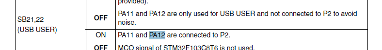

2013-10-11 12:46 PM
I know it's easier to fumble around and ask here, but the
http://www.st.com/st-web-ui/static/active/en/resource/technical/document/user_manual/DM00063382.pdf
