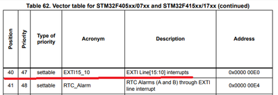

2024-12-13 7:44 AM - edited 2024-12-13 7:46 AM
@Khansokhua wrote:
I can only see five handler in start-up file for STM407.
.word EXTI0_IRQHandler /* EXTI Line0 interrupt */ .word EXTI1_IRQHandler /* EXTI Line1 interrupt */ .word EXTI2_IRQHandler /* EXTI Line2 interrupt */ .word EXTI3_IRQHandler /* EXTI Line3 interrupt */ .word EXTI4_IRQHandler /* EXTI Line4 interrupt */
Look at the table Table 62 in the reference manual:
Look also at the start up file .s.
2024-12-13 8:13 AM
Everything fits perfect now , thanks for your help @Tesla DeLorean @mƎALLEm
