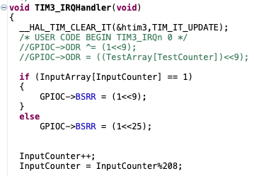

2021-02-10 5:47 AM
Thanks for the answers!
I'm using an STM32F407 discovery board.
I've managed to get it working using the method suggested in this article (from the link you referenced).
If someone else is interested in my solution, I've added a screenshot of how my interrupt routine works. Otherwise you can take look at the Github link provided above.
As i'm starting to become aware of the limitations of my approach I'm gonna start looking into DMA, SPI and I2S. Thanks for the advice!
