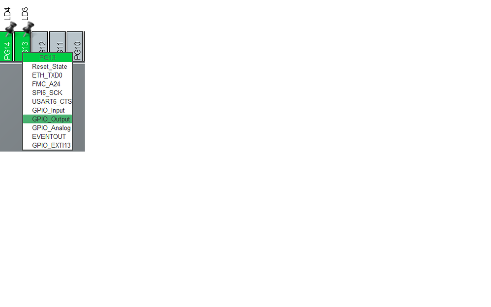

is it possible that when the output compare is triggered, the PIN of the timer of my channel goes directly to the LED?
Because for the moment, I have configured the TIMER channels directly on the LED PIN.
On my STM429, I can't select any timer going to my LED pin (attached image), how can I make the channel timer corresponding to my output compare to be linked to this pin ?
I don't know if you see what I want to do, I hope so.
Thanks you,
2021-01-22 12:20 AM
If you leave the LED pins (PG13 PG14) in the Reset_State (no Output) you may safely connect a wire from the timer channel output pin to the LED pin to make the LED blinking.
If you don't like wires and timing is not very critical, you can enable a timer OC interrupt and toggle the LED from the interrupt handler in software.
Note that OC is only a short pulse (unless you use Toggle on Match mode). You may also look into PWM mode for dimming a LED.
