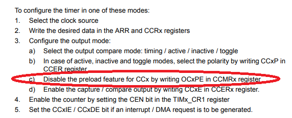

sConfigOC.OCMode = TIM_OCMODE_TOGGLE;
sConfigOC.Pulse = 0x00000001;
sConfigOC.OCPolarity = TIM_OCPOLARITY_LOW;
sConfigOC.OCFastMode = TIM_OCFAST_DISABLE;
if (HAL_TIM_OC_ConfigChannel(&htim5, &sConfigOC, TIM_CHANNEL_3) != HAL_OK)
Error_Handler();
__HAL_TIM_ENABLE_OCxPRELOAD(&htim5, TIM_CHANNEL_3);

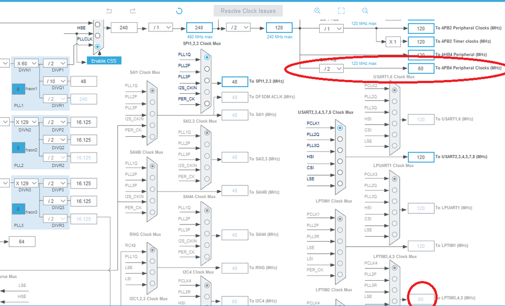

Thanks, the clock configuration for TIM3,4,5 looks correct at 60Mhz. What else could be causing it to be off by 2x?
2020-06-28 1:16 AM
TIM5 is in APB1 domain. Don't confuse TIM5 with LPTIM5, that's an entirely different timer.
APB1 Timers are clocked by rcc_timx_ker_ck , see Ratio between clock timer and pclk table in RM.
2020-07-04 8:21 PM
Thanks, the clock was 120Mhz, so the timer output is good! Maybe a little TOO good, I can't seem to stop it. I have an adc configured to trigger based on the Timer 5's Trigger event, and I see the dma update the memory with new adc data.. however, despite stopping the Timer's base and OC, I still see new data coming into the buffer! Any insight what might be happening?
