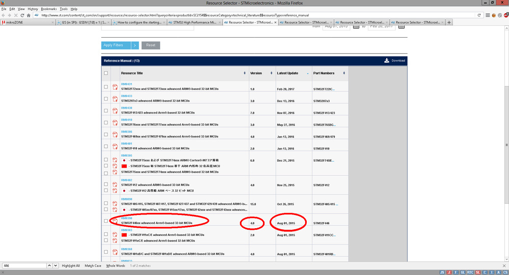

2018-03-03 1:41 AM
Hi
garsi.khouloud
could the date of RM change also be updated in the Resources selector?
Thanks,
Jan

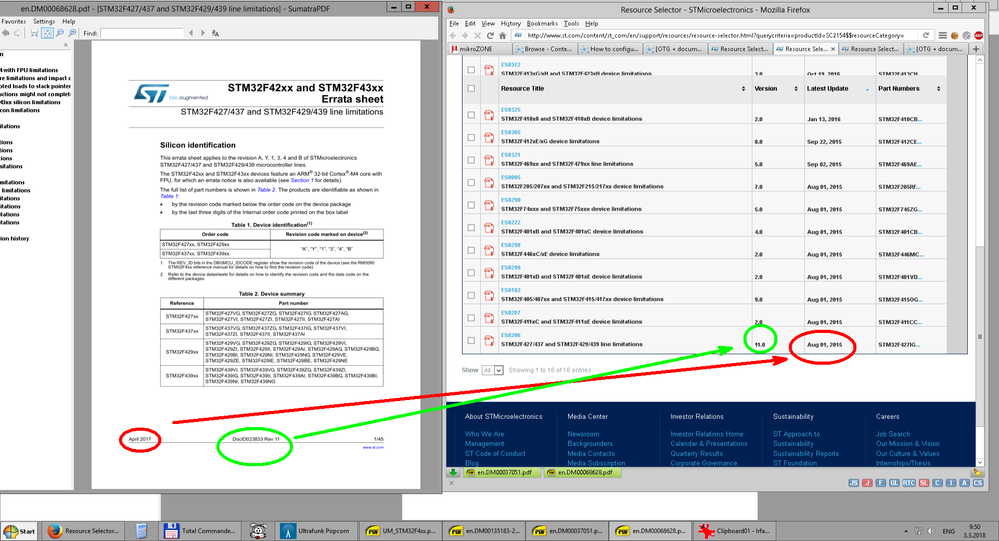

[EDIT] PS. This appears to be a more widespread problem...
https://community.st.com/0D50X00009XkaRZSAZ
[EDIT2] Yes it is... a random example, I checked half a dozen RM and DS and ES and *all* had incorrect date...
In the above linked thread I'll discuss the importance of maintaining this information properly.
2018-03-05 3:33 AM
Hi Jan,
I have highlighted this internally. Sorry for any caused inconvenience.
Khouloud.

2. The 'Latest update' column in the 'Resource Selector' is updated correctly now.We really thank you for highlighting all encountered issues through our Forum, this helps us to enhance the quality of our documents.
