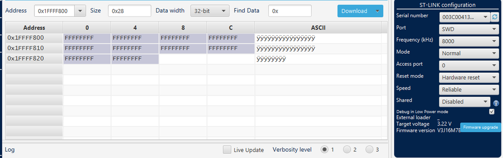

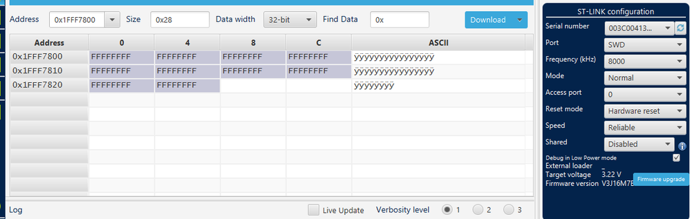

The chip model we use is STM32L496VG. Our customer reported that the machine became unresponsive (bricked) and couldn't power on after an OTA upgrade. After receiving the machine, we used STM32 Programmer to read the flash, which prompted chip protection. When we read the option bytes (OB), all contents were found to have become 0xFF. We checked the code but found no section that writes to the OB, and we haven't been able to reproduce the issue. Currently, we want to know under what circumstances the OB would all become 0xFF and what possible causes there might be.

We can't read the flash at 0x08000000 if option bytes are 0xFF but can read the contents of OB. We also believe that only software can cause the option bytes (OB) to become 0xFF, but currently we are unable to reproduce the issue or locate the problem. Anyway, thank you for your support.
