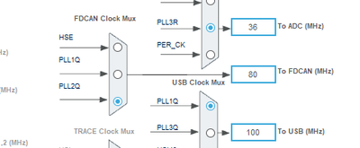

2025-07-14 11:08 PM
The timming depens on the FD CAN Input clock (in Your case this seems to be 80MHz), You can finde tis on the Clock Configuration page:
2025-07-14 11:00 PM
You need to know the FDCAN clock frequency. Then you can use this link to calculate the correct values
https://kvaser.com/support/calculators/can-fd-bit-timing-calculator/
2025-07-14 11:08 PM
