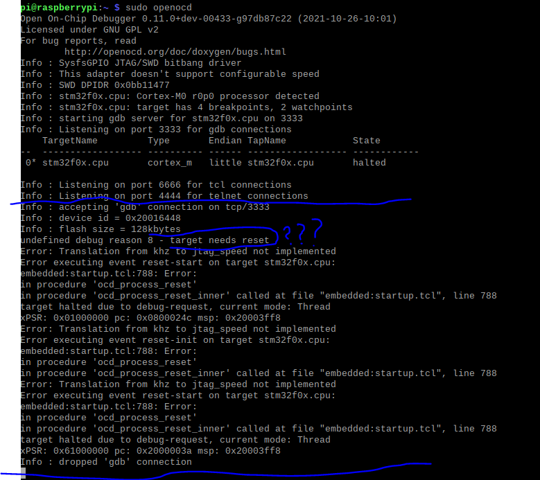

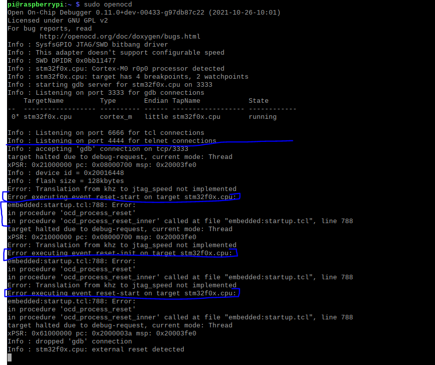

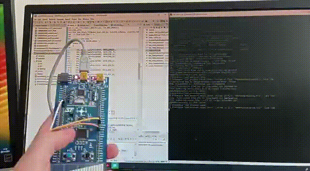

Trying to build my own raspberryPi wireless SWD debugger.(bitbanging SWD, without stlink)I am able to flash and halt the code trough cubeIDE but openOCD is not able to reset the chip, i have to do it manually for now (see gif above).
Pesky errors im getting:
error in procedure 'ocd_process_reset'
Error executing event reset-start on target
Error executing event reset-init on target

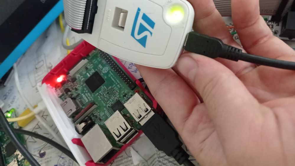

i gave up, im sticking an stlink to my raspi
openocd.cfg file changes :
source [find interface/stlink.cfg]
transport select hla_swdit works first try, everything

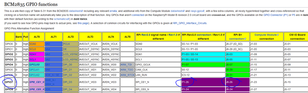

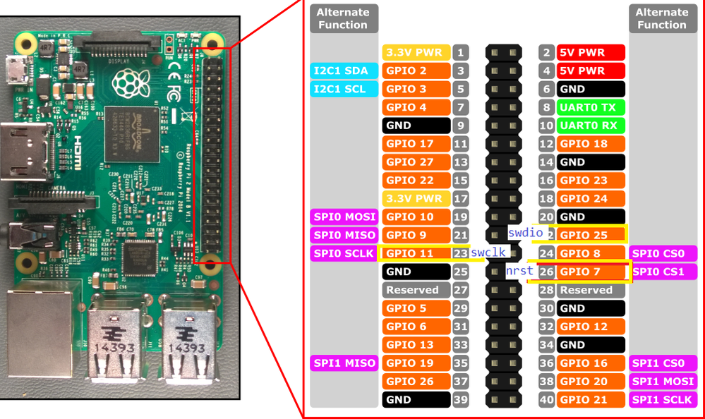

2021-10-26 6:11 AM
looks like i got the pin number right but im going to try other nRST pins just in case
