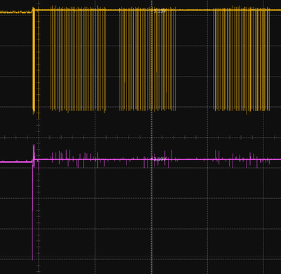

iIm currently trying to program an STM32F0x MCU with an CMSIS-DAP interface on openocd, but i'm currently able to generate only an useless reset signal :
In Yellow the SDIO and in Purple the RST

shutdown command invokedI think my connection is okay, but break after a moment.
My controller have been programmed once with this method (only GND SDIO SCLK) but without nRST signal, I have added them because i can't halt the MCU with software reset to reprogram them ...
Is ST-link use an special reset feature that i haven't see ? or maybe my configuration is incorrect:
openocd -f interface/cmsis-dap.cfg -f target/stm32f0x.cfg -c "reset_config connect_assert_srst"
